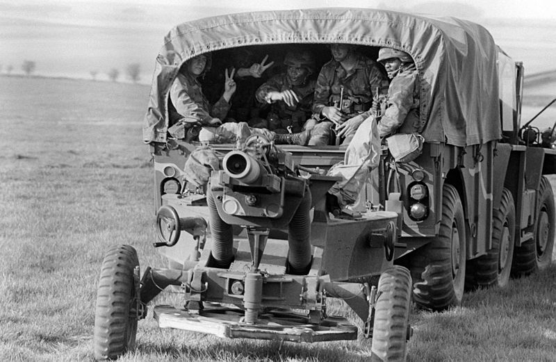

Posted: Sunday, October 01, 2017 - 06:48 PM UTC
I seem to remember that they were towed by M561 Gama Goats.
NATO Exercise Ardent Ground '87, Salisbury Plain Training Area in Wiltshire, England :
