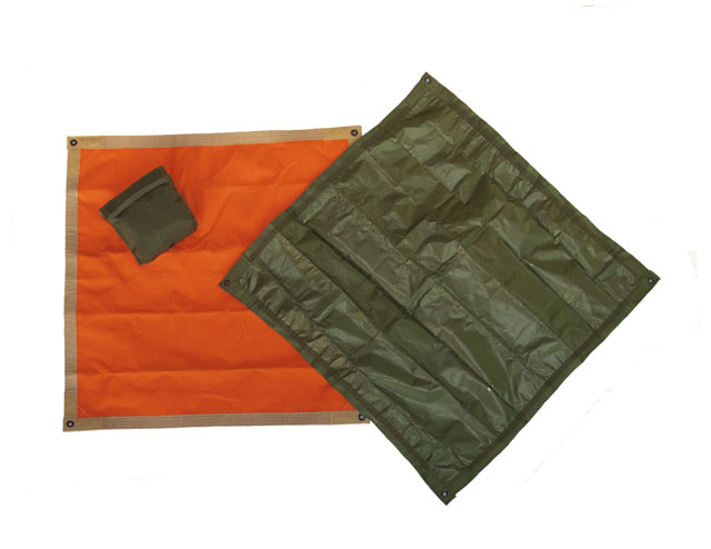

From the pictures in Prime Portal, I intended to depict a "standard" orange air recognition panel. I don't know the VS 17 thing you're talking about.
If I'm correct the panel comes with OD edges.
Olivier
Olivier

H.P. the pictures at Prime Portal show an orange panel. From the angle it's hard to tell whether or not the panel is square or rectangular.
If I'm correct, whatever the type of panel I use, one side is orange or tan, the other side is olive green.
Olivier
Olivier

Posted: Wednesday, February 07, 2018 - 05:46 PM UTC
Old ones were orange and OD green.
The newer versions are douple-sided with one orange side and one magenta side and an OD pouch at one end to store it in.
