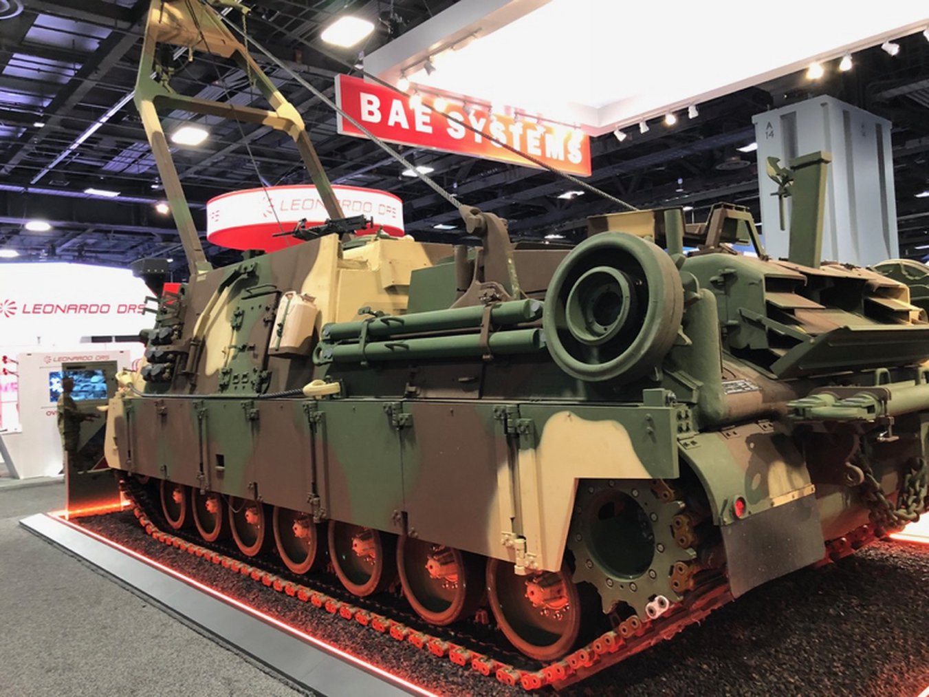

Interesting news, thank you for the link. The M88A3 configuration features an upgraded powertrain, suspension and tracks, increasing the vehicle’s speed, survivability and reliability.
The M88A3 also features a seventh road wheel to reduce ground pressure and new hydropneumatic suspension units (HSUs) that enable the track to be locked out for greater control when recovering vehicles, say BAE in a release. Does not look like a straight forward conversion of existing kits, either.

Interesting. Externally, it looks only to be different in the suspension and roadwheels, which are closer together to fit the 7th one. The rest of it looks like an M88A2. Looks like it has T158LL tracks too.

M88A2 from roughly the same angle if someone wants to compare wheel spacing:
The tighter spacing on the A3 is rather obvious ..
That canvas cover could be a modelling workaround if the small topside details have gone missing from the kit ...

First thing I did was compare pics to see how they squeezed that extra road wheel in. Looks like the engine deck is a bit chunkier too.

Funky colours used in that three tone, too.
Robin, love the image with the cover on. Casper the friendly recovery vehicle!

Did a little Googling, and saw the new suspension is hydro-pneumatic - that explains how they shoe-horned an extra wheel into a hull originally perforated for six torsion bars! When it comes out in plastic (hint to Takom, Meng!) it'll be well-cool.

If it is the full hydro-pneumatic suspension arms the they've done away with torsion bars.

It does seem odd that they're still using the M60-based machine and not going to an M1 base. Heck, if they can stick an M109 turret on a Bradley and call it the A7, why can't the M88A3 be M1 based? Ah, well, if only the model companies put it out in 1/35 styrene then I'll be happy.

It comes down to cost. It is still cheaper to upgrade the M88 than it is to make an all new, M1-based recovery vehicle. The M1 ARV would actually have to be bigger than an M1 to pull it, which makes it an even more expensive vehicle.
As the the M109A7, it isn't a Bradley hull at all. It is on an all-new hull that uses Bradley running gear and drive train components, thus making it a more common parts stream with the Bradley.

No, it certainly does not. Just look at spare track links on the hull. That is some new track type.

Dead-on as usual, Pawel. It appears to be some type of replaceable chevron, judging by the pictures. There's also a hollow center guide, and i'd feel safe in guessing that it has the same 28 inch width and pitch as the old T107.
