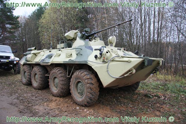

I seen both 3 and 4 firing ports along the right side. Are both of these versions correct?

Doug, you're right. Both versions exist. My guess is that the 4-port version is the early one. I've seen some in service with KFOR. When you look at pictures of ISAF deployed BTR-80A there are only three ports remaining.

I have never seen any A versions with 4 ports (although this does not prove anything

unless I'm wrong the A version is the one with the 30mm cannon and I've seen vehicles with either 3 or 4 ports, with the early wheels or the late wider ones. But I could be confused with the A type.

I have plenty of references as Hungary might be the biggest operator of BTR-80As as we have received loads from Russia when settling the national debt. As a result we have factory original BTR-80A-s.
As for the versions with 4 ports I still need to ask around, but I presume these are old BTR-80s upgraded with the new "A" turret. Like on the picture of Mokush - this seem to be originally an early BTR-80 because:
a) it has short handrails on the sides
b) it has rounded rubber shock absorbers on the front
c) no wider body
Also BTR-80As should not be confused with BTR82As - seen frquently Crimea operated by Russia -, which are quite similar

Just found photos of the Trumpeter BTR-80A:
http://www.1999.co.jp/eng/image/10287083p/10/1
Looks like we get the hull of the late BTR-80 kit (my opinion only as the late BTR-80 is not yet released) so it has 4 firing ports and missing the 4th driver's periscope on the left. But the rest looks correct for a decent BTR-80A with new tires and wider hull (these horizontal parts over the wheels are separate ones so the same hull can be used for multiple kits).
It is a bit letdown, although getting rid of the firing port is easy, but adding the 4th periscope needs some surgery.
Oddly enough the paining guide does NOT have the 4th firing port...
