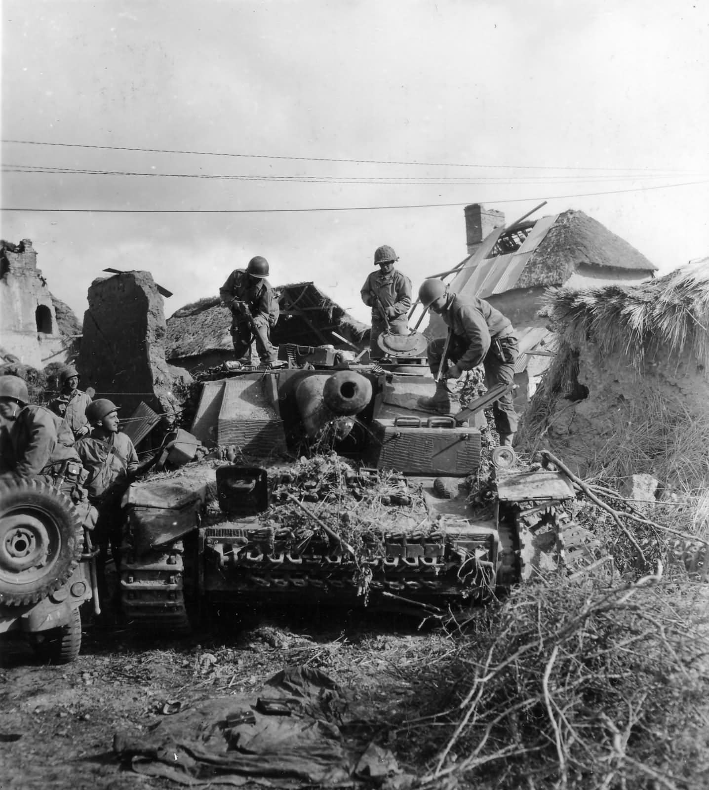

All the GvB StuG IVs I have seen have Zimmerit. Didn't know that Lehr had any - they were mostly issued to infantry divs (of course it could be an error). On my HDD I have a list of recipients so can check in a couple of days if Lehr received any.
Posted: Saturday, January 07, 2017 - 05:23 AM UTC
This kit has the Ausf J chassis if I am correct. That tank entered service in the Summer 44, so with Zimmerit cancelled in Sept '44 few if any Mid Stug's would have had Zim I would expect.
The only issue here is that the fighting in Normandy was mostly over by the end of August, so with that in mind the two Normandy options should have Zimmerit applied.
Most Stug IV's were based on the Ausf H chassis.
Two Stug IV's with Zim
