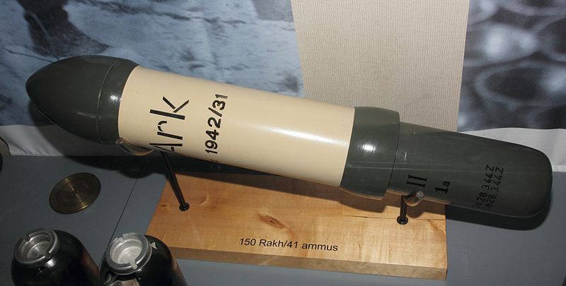

What about these ?
http://www.bocn.co.uk/vbforum/threads/3887-15cm-Wgr-41-Nb-for-the-15cm-Nebelwerfer-41
H.P.

Posted: Monday, May 22, 2017 - 04:21 PM UTC
More views :
H.P.
H.P.
Posted: Monday, May 22, 2017 - 05:49 PM UTC
Thanks all for the responses. H.P. that is quite an arms cache you have there! Doing some digging as well:
With all these photos I guess its safe to go either single color or one that has this light band on its body.
Cheers,
Tat
Cheers,
Tat
