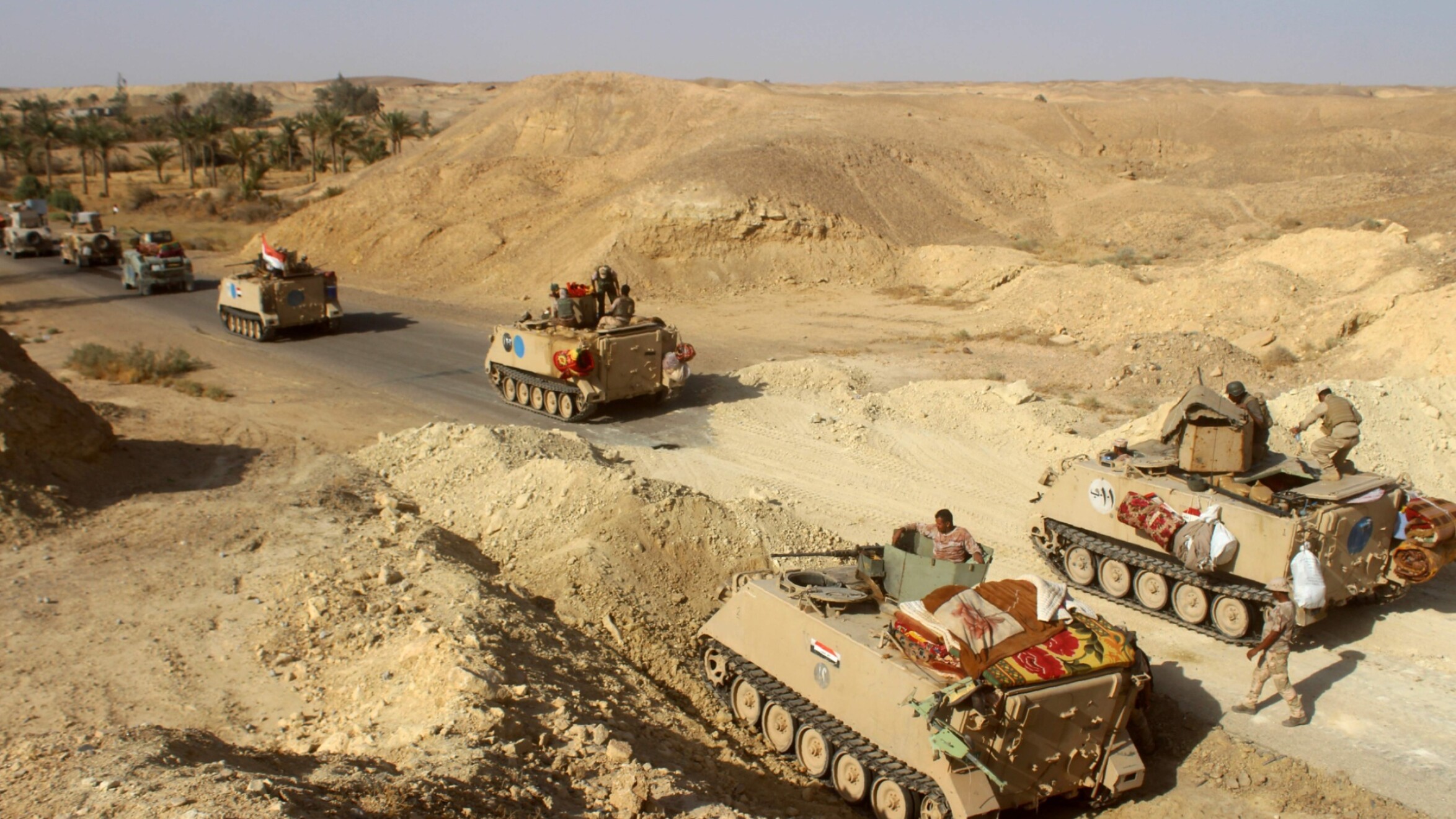

Here are a few more Iraqi Army M113A2's :

Not sure you need the Dshk. From the pics, it looks like most (if not all) have US M2 .50 cals on them.
Agree. The only ones I've found so far are fitted to APC's captured by ISIS :
