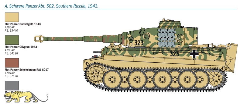

I want to model this one:
![](../../../www.axels-modellbau-shop.de/katalog/images/product_images/popup_images/14689_10.jpg)
