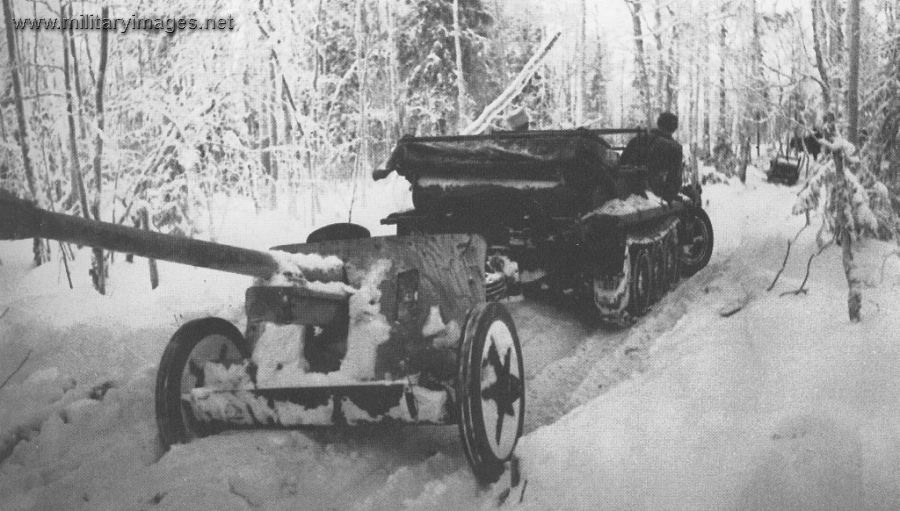

Some whitewash camo reference:
Patton Museum Photo from the Icks Collection
military images.net - used here for discussion purposes only.
Personal theory: Solid whitewash only works in a freshly fallen snow environment. Partial, blotchy whitewash works far better as snow camo in the much more typical "old snow" environment where there are darkened trees, dirty snow, melting water puddles and dark areas of ground showing through the blanket of snow.
