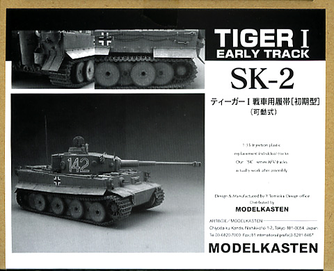

If you are interested...
Spade Ace do this one:
Model Kasten
Rye Field Models
and AFV Club 35094 is an alternative, (but pin marks need to be dealt with).
Model Kasten
Rye Field Models
