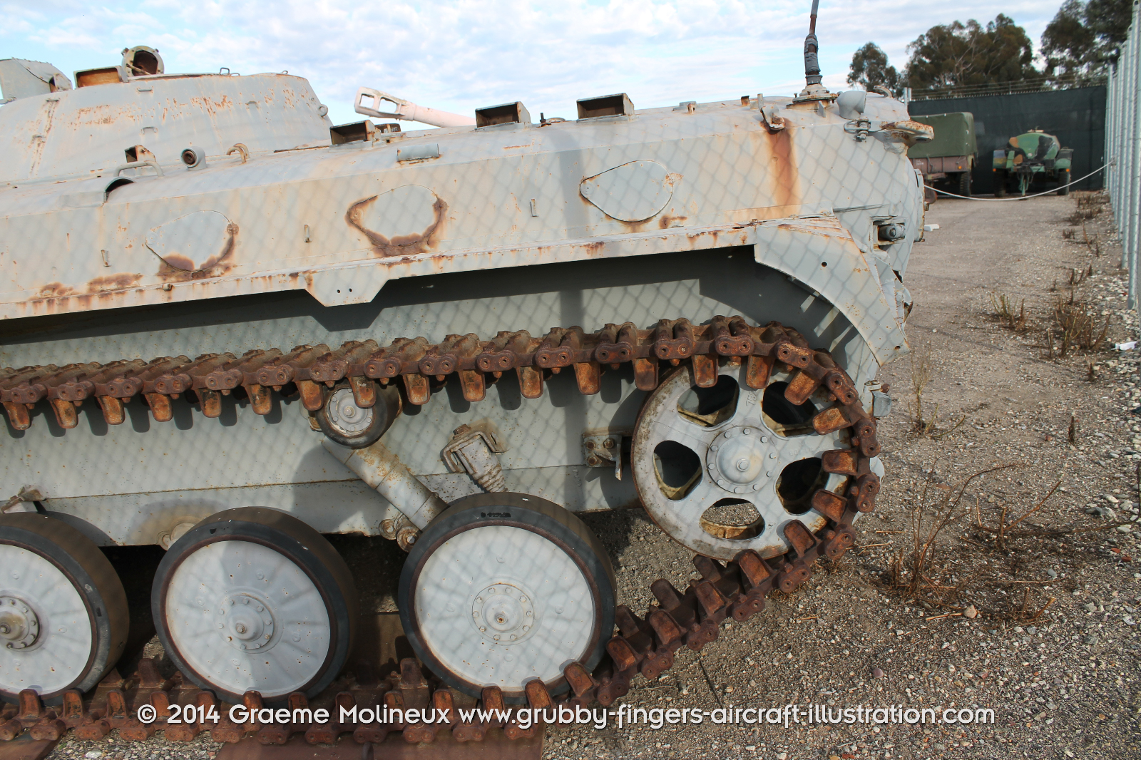

Some "modern" Russian vehicles also have double-pin tracks. If these links are moulded in one piece with the end connectors (and sometimes also a center connector/guide horn) then it will work just fine for straight or nearly straight sections,
it can look a little odd when bent around the first and last road wheel,
it will look ugly when bent around the idler and
it will look horrible or maybe not even fit when bent around the sprocket wheel.
The end connectors must be angled in relation to both of the links it connects and that requires some brute force or cutting and gluing to get it right.
/ Robin
