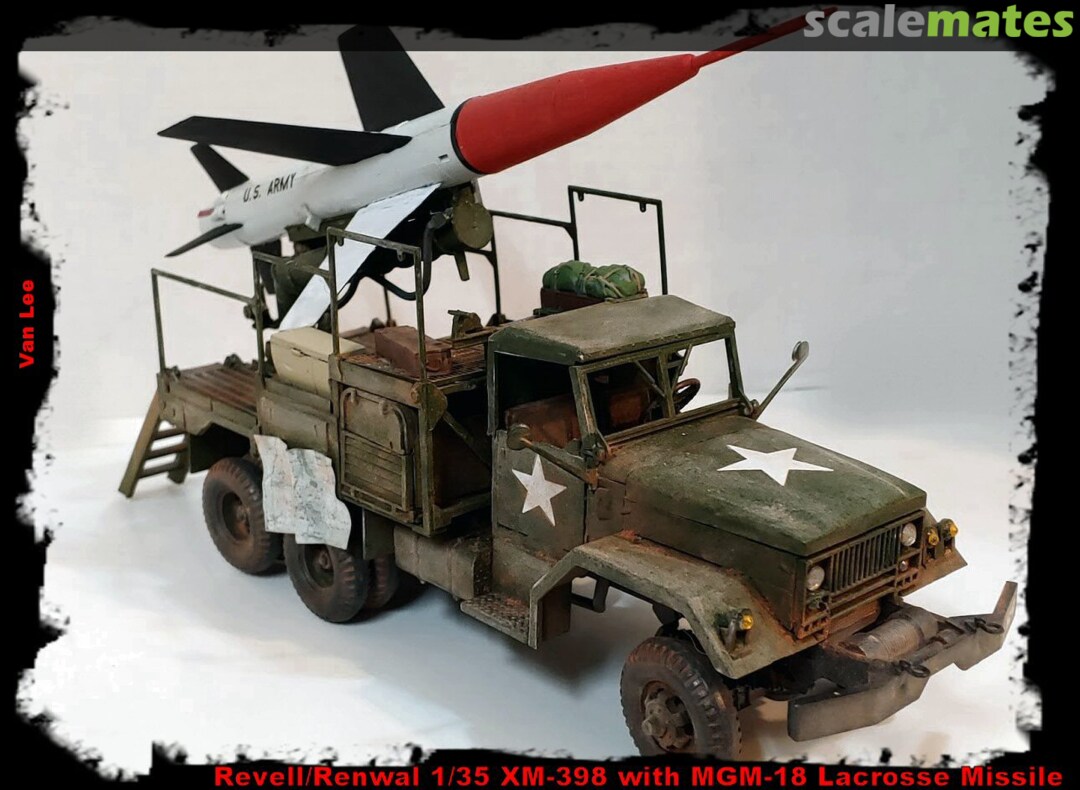

The Lacrosse missile had a missing wing. The kit is well out of issue, so I couldn't contact Revell for a replacement, so I had to fabricate one, the one on the near bottom. Handy use to recycle part of the box it came in! I just printed out a miniature map of a military installation in the New Mexico to hand for the crew to use.
The stowage seen in this one is a few pieces from Value Gear. Their stowage is pretty reasonable and I highly recommend them.

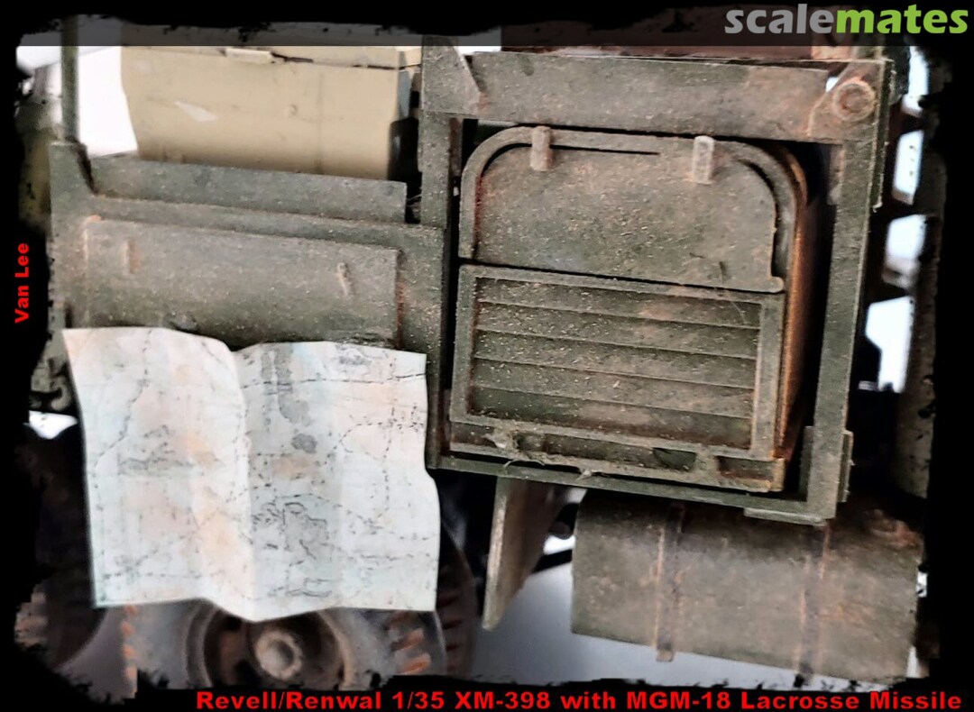

Close up of the map. I have included maps in a lot of my builds of vehicles from the 60s. They didn't use GPS back then, so I feel it is a nice touch to add. That panel opens up to the missile control panel, so seemed like an appropriate place to put it.

Painting lights tend to look fake, but I saw where someone on this same kit used beads to make the lights. My wife is into 5D bead kits and has a lot of extra beads, so I found some clear ones and some amber and red ones to make the lights for this build. I am really happy with how that turned out.
You can see the red and amber colored lights on the rear. Dry brushed some silver on the ladders to denote a lot of walking up and down them.
Overall, this old classed was a joy to build. Old Renwal molds have a lot of character to them. I have also built their M47, Teracruzer and Atomic Cannon and they all add some unique flavor to my collection.
