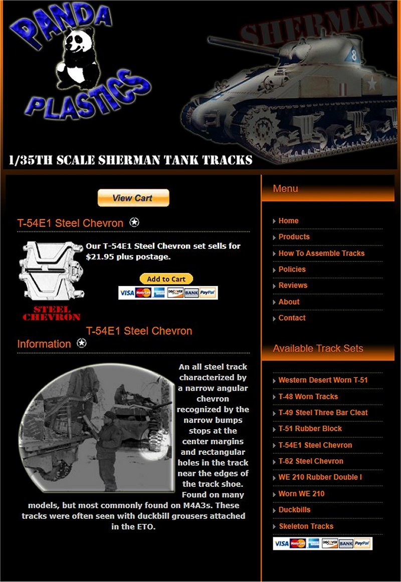

Here are the BEST AM Sherman tracks on the market...Take note Meng and Rye Field, We don't need 10 parts to make one link!
http://shermantracks.com/
