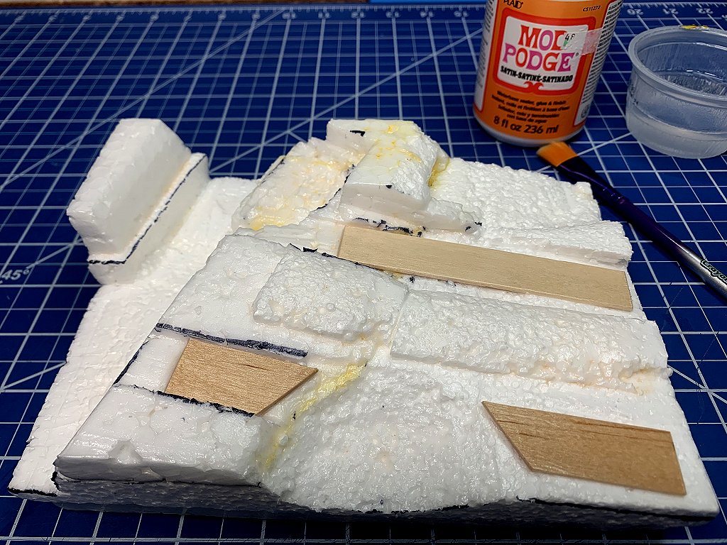

After you carve the design of the layout are you going to seal it in before adding any texture?

Posted: Tuesday, September 01, 2020 - 08:15 AM UTC
Thanks Everyone for Stopping In and Leaving Your Comments!
Since Greg asked, here is where I'm at on the base as of today. Once all the carving is finished and them thousands of statically-charged bits are sucked-up with the Dustbuster. I then apply two or three heavy coats of Mod Podge, two coat this time to strengthen the styrofoam and prevents warping. Once this drys thoroughly I'll start adding the groundwork.

Did you take the styrofoam off the base individually and spray it or did you just
Spray it in place with the mod podge?

Did you take the styrofoam off the base individually and spray it or did you just Spray it in place with the mod podge?
Not sure if I totally understand the question Greg. All the styrofoam elements are glued together with PVA. After 24 hours I then apply the Mod Podge. The Mod Padge is brushed on as its way to thick to shoot through an airbrush.
Hope that answers your question. If not let me know and I'll try again.

Nope that answers my question, thank you!

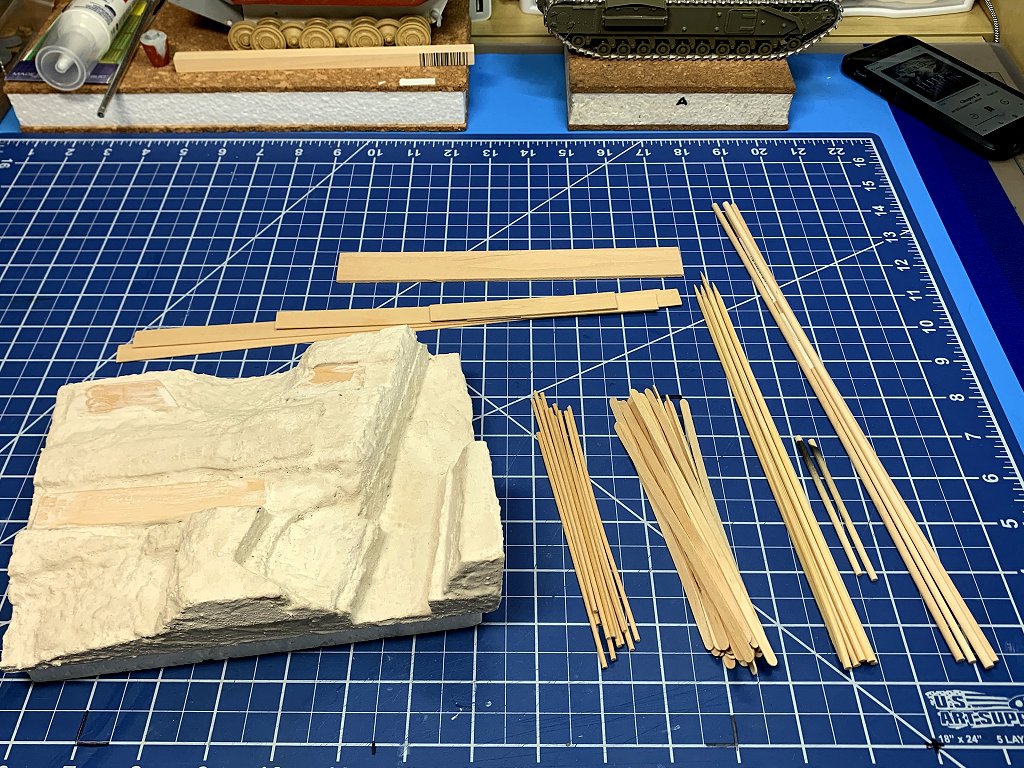

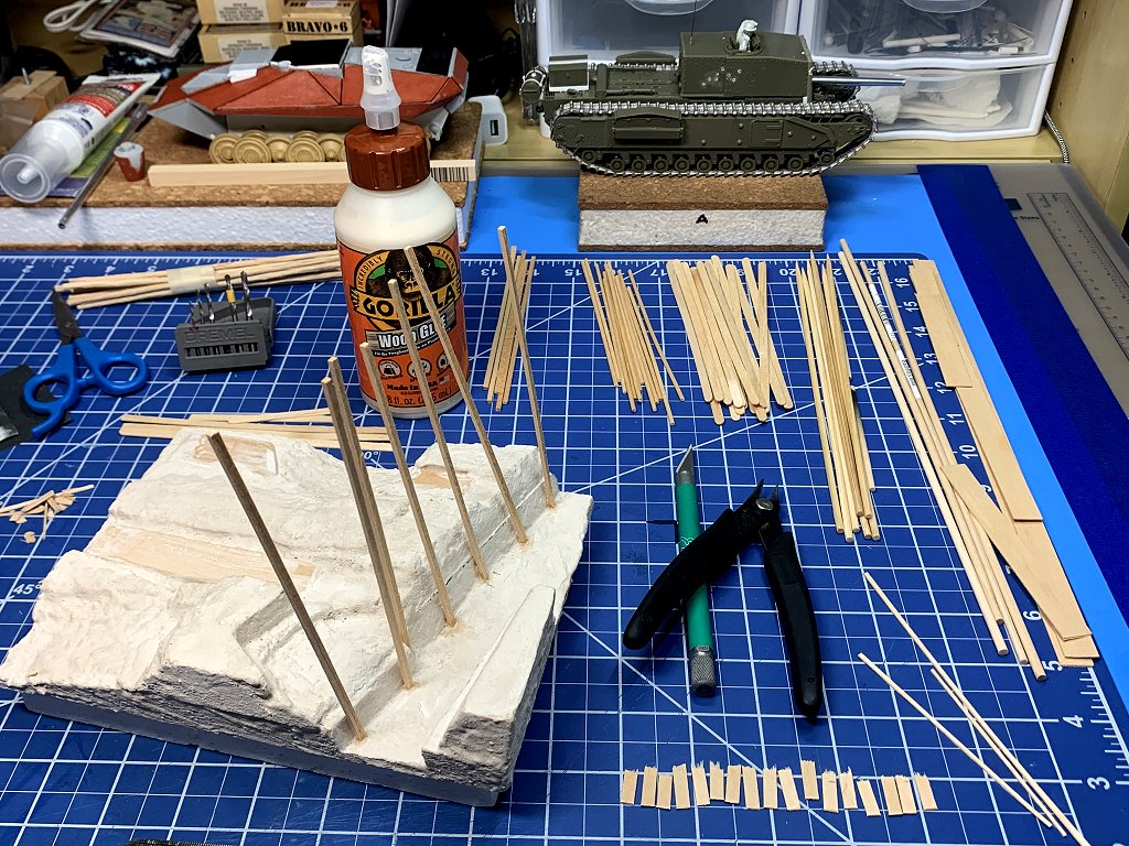

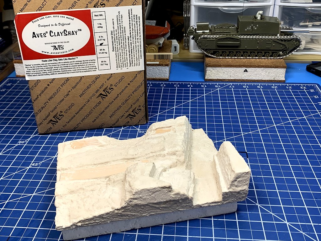

Made a little more progress on the base.
First up is I gave it an over all thin coat of Aves ClayShay. This material is like if paper mache and plaster had a baby. Mix with water and I add some PVA for good measure. This further straightens the styrofoam and will help additional layers of ClayShay stick to the styrofoam.

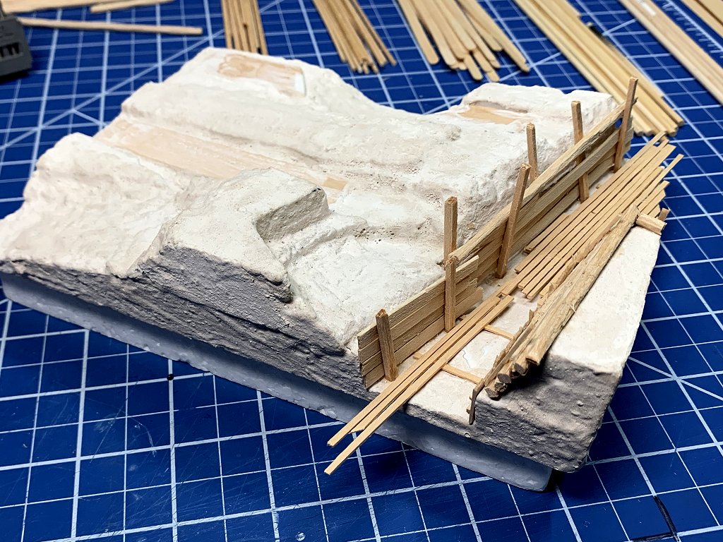

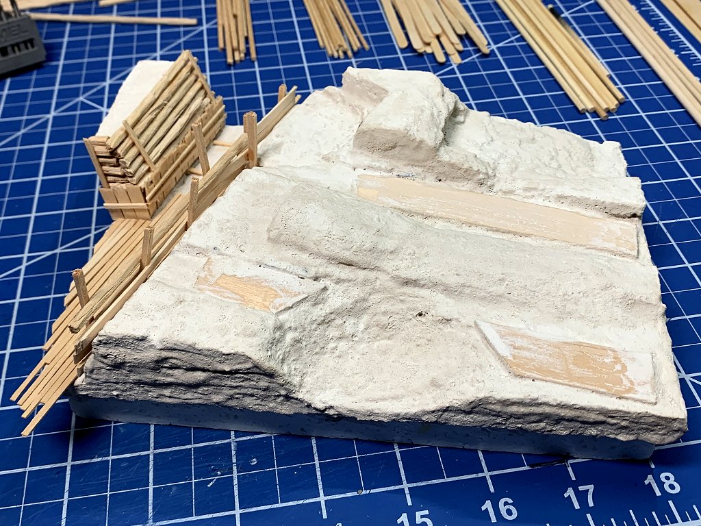

Next I started on the trench elements. I used mostly bass wood that I had in my wood pile. These elements are glued in place using PVA. I used several different patterns for the wood structures to add visual interest.
That's it for this week Thanks for Stopping in. If you have any questions please feel free to ask!
