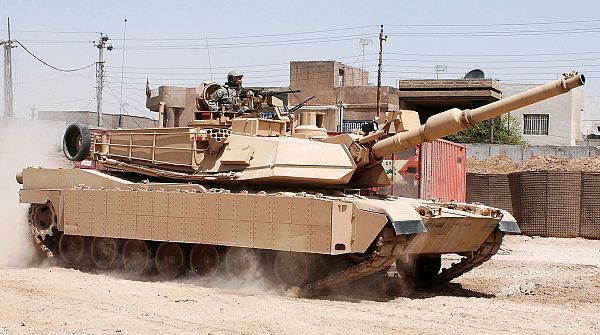

True enough, but it also depends on the angle of view. Again, as I said, there is no really wrong way to paint optics, and like you said, to each his or her own.
Here are photos of the optics really bright red and also Clear Blue over Black.
https://nationalinterest.org/blog/the-buzz/inside-the-us-armys-lethal-new-m1a2-sep-v3-abrams-main-16445
This one shows Clear Blue (Gunner's Primary Sight (GPS)), Clear Green (driver), and Clear Red (TC's hatch).
https://www.strategic-planning-us.com/2019/12/abrams-sepv3-tank-MBT.html
Bright red again...
https://www.motherjones.com/politics/2012/07/abrams-tank-pentagon-defense-lobby/
So perhaps we're both right. Gino said to paint black and then Clear Red and then perhaps one or two viewing prisms paint Chrome Silver and Clear Red. The GPS seems to be Clear Blue.
