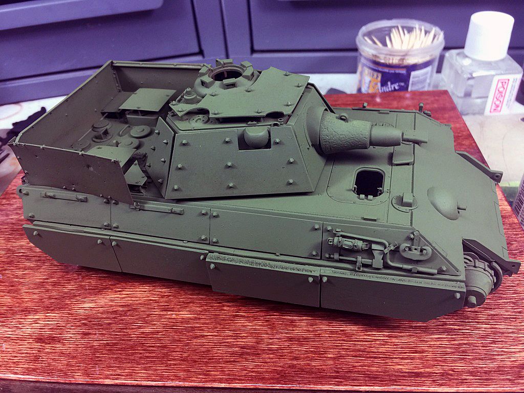

Tried out a different method of texturing a muffler. Muriatic acid. Etches the aluminum quite quickly but stinky. I had windows open and fans blowing. Added on some Mr. Surfacer 500 on the piping and started the painting/weathering process. Still have a little ways to go with weathering.

I like the looks of your Panther. Be real careful with that acid, the fumes can harm your lungs.
