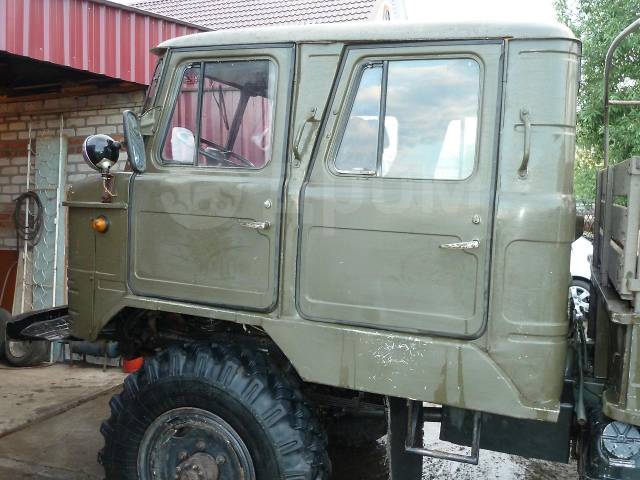

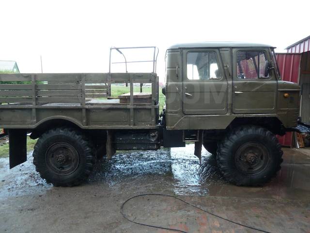

Well another question for my panel of experts:
Now this time I am once again talking about the regular GAZ-66 4x4 truck:
Has anyone ever seen a four door, crew cab GAZ-66?
Either on a standard length frame with a shortened loadbox OR on a longer frame with the four door cab and regular length loadbox? Mercedes builds them for their Uni-Mog so I was just wondering.

Guys, any input on the question of the existance of a crew cab GAZ-66 ???
I an certainly thinking of building one! (Since I have the extra cab and all these extra parts.)
I would go with a standard 4x4 and standard frame length, shorten the loadbox and move the spare tire to inside the loadbox. Loose all that other boxed gear behind the cab.
Do a kind of Unimog "thang" with the vehicle!
(F.Y.I. - "Thang" being a US, back-woodsy, slang mis-pronounciation of the word "thing".)
Rhone, France
KitMaker: 12,719 posts
Armorama: 12,507 posts
Posted: Sunday, October 28, 2018 - 06:53 AM UTC
Just another version. Looks like they've used a truck rear axle for the semi trailer...
_GAZ66_Page_5_Image_0004.jpg)
Another tractor prototype was based on a GAZ-53 4x2 chassis fitted with a -66 cab :
Still looking for a crew cab...
EDIT
Longer variant :
Even longer...
You can even swap the whole cab for a Japanese-made one :
Here's the largest cab I've found
_GAZ66_Page_5_Image_0013.jpg)

Posted: Sunday, October 28, 2018 - 04:51 PM UTC
Thank you sir. I couldn't have hoped for better.
A short crew cab version is definitely in my future!
