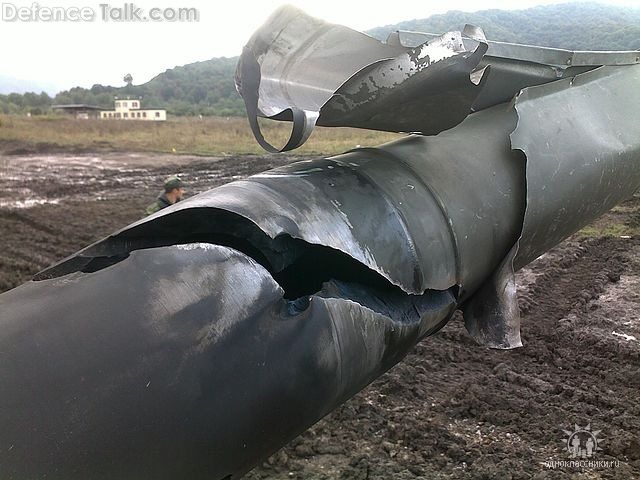

Seriously most pictures of guns which look like bananas are caused by muzzle burst. This is caused by worn barrels or faulty ammunition, or a round "cooking off" in a hot breech.

For your entertainment.
https://www.defencetalk.com/military/images/t-90a-19th-mrb-tank-btln.42869/full?d=1514060940
