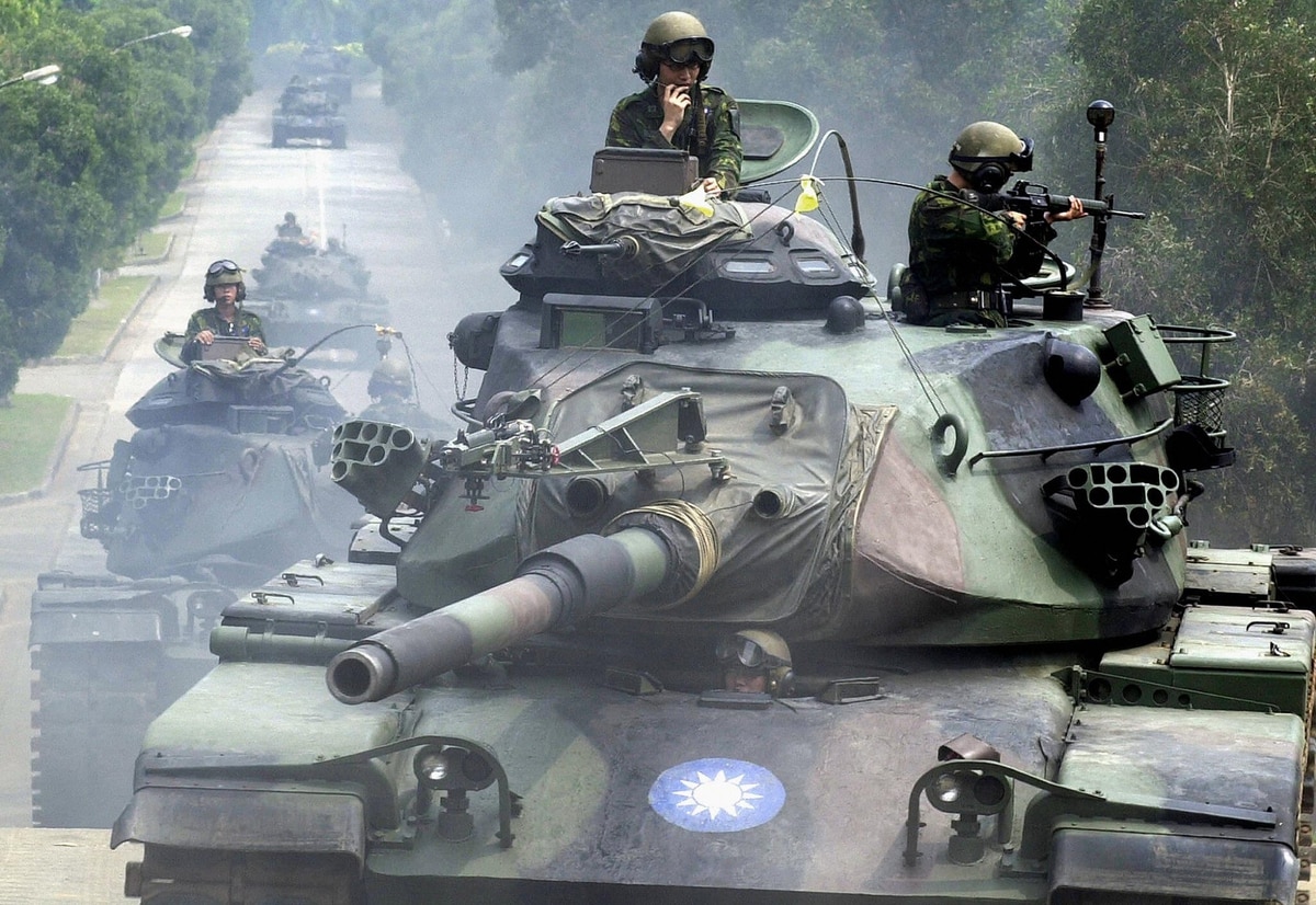

I look at some pictures of tanks and to me they dont look dead flat, to me it looks like some painted surfaces have a very low to satin gloss?Do you guys agree?does anyone mimic that buy adding a little gloss paint to the dead flat at like 90% flat to 10% gloss?

Most of the paint I use is not dead flat. Most military vehicles have a sort of satin finish. Weathering will flatten the sheen depending on the amount of weathering.

Are you sure you're not looking at a wet vehicle? Our CARCed up rigs were flat. Even Krylon touch ups were not as flat. Tanks, Humvee's, Bradleys, 5 tons, deuces, CUCV's all flat. The only time I've seen vehicles with a "sheen" were coming off the wash point, in the rain or coming out of the river. The only vehicle I've seen with a sheen when dry was Stormin' Norman's jeep at the Ft. Lewis museum. That thing was polished within an inch of it's life. Rumor had it that his drivers got that shine by using Dexron but I always suspected armor-all.

I think it’s an illusion, I use dead flat finishes but even then at certain angles (like a raking light) it can reflect a sheen. But you have to ask the question, if you’re trying to camouflage an AFV is there any earthly reason why you’d risk giving it a sheen that would bounce sunlight straight into the eyes of the enemy? You might spoil their aim by dazzling them for a few seconds I guess…

I would say that the surfaces in the images above are not dead flat. Even if they were dead flat it will look strange on a model
Replicating this surface on a model in 1/35th scale is not done by a dead flat surface:
https://www.militaryfactory.com/armor/detail.asp?armor_id=1 (12 images of an M1 Abrams)
A really flat paint on a model will give the impression of the real object being covered in velvet.
/arc-anglerfish-arc2-prod-mco.s3.amazonaws.com/public/7FD5XIIPKBHNTIFT7CWLBQNRFY.jpg)
This one is really flat but there are still highlights. In 1/35 it would be a little shinier than dead flat.

Perhaps it depends on what you consider matte, flat or satin. Dead flat would be clothing. Smooth metal painted flat colors, like a primer, would fall into that category. Primer has a surface that is almost textured to give tooth for the paint to stick. Smooth, flat colors on smooth metal could probably be a satin. Scuffed paint and areas where people climb or crawl could also be different from surrounding areas that aren't worn.
That bottom Leopard almost looks damp.

Gloss paint goes matte/dull after a while out in the real weather. I remember the matte pink look on red Volvos in the 80'ies .....
Matte paint jobs have a slight sheen after a while.
Compare Tims model images with the ones I dredged up from the internet (took me maybe 10 minutes).
I call this satin or maybe slightly matted satin. If someone wants to call it matte then be my guest
The last Leopard image: The ground is dry and the mud stuck in the wheels looks dry but it does feel as if the tank itself is damp/moist.
