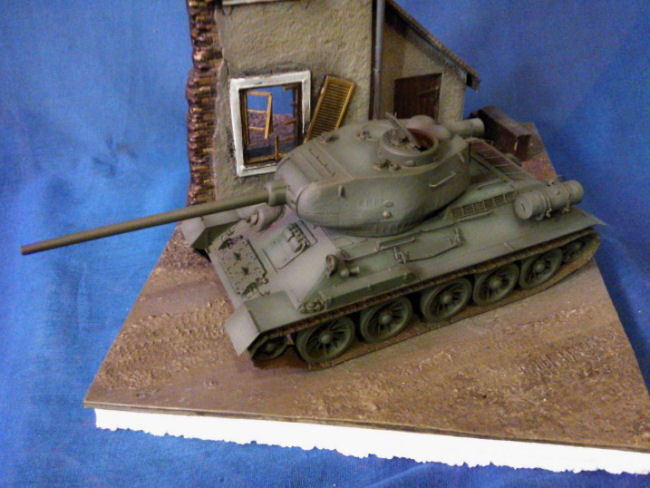

awesome!! next time try 3 light coats between panels,boxes . leaving the black basecoat somewhat visible through the diluted topcoat.Next lighten your topcoat with fleshtone & lightly spray inside the first top coat. So the black & topcoat help emphasize the edges while lighter topcoat lightens inside panels. use this same light topcoat for your dry brushing edges.
my 8 cents.
you will get this affect
