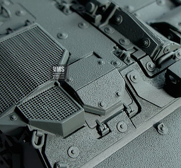

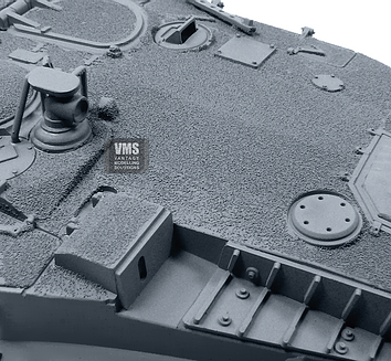

Welcome back, VMS offers a couple of products that seem to have good results:
https://www.vms-supplies.com/vms-hull-tex
https://www.vms-supplies.com/vms-hull-tex-air
